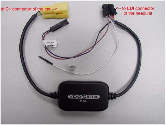

RC6204/00 - EDI Renault Interface Accessory
Why this Product? With the RC6204/00 EDI interface the user can connect the radio or navigation system directly to his external display and SWRC (steering wheel remote control). Following models are supplied:

Design and Feature USP´s
Renault EDI Box - RC6204/00 is designed to be connected via EDI interface per Plug & Play to all Renault cars.
Dimensions are very small (HxBxD = 5,8x3,4x1,6 cm).
Renault EDI Box - RC6204/00 is designed specifically to function with following Renault car models (for car with I2C bus):
  • Laguna_1 & Laguna_2
  • Megane_1 & Megane_2
  • Clio_1 & Clio_2
  • Kangoo
Planned Launch Date - July 2004
Renault - EDI Connector Matching Overview
Connection RC6204/00 - Audio
RC6204/00 Accessory Pack
Renault EDI Box - RC6204/00 For Renault car with SWRC and external display screen in the car panel A2C = A2C53088550 EAN = 4025515255291 Allows you to operate the radio headunit with original Renault SWRC and show the info in the Renault original car panel display screen
